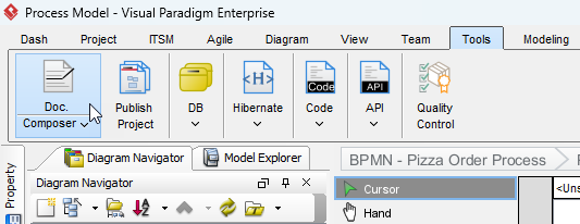

- Go to Tools > Composer.

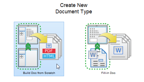

- Select Build Doc. from Scratch.

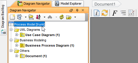

- Select project root node.

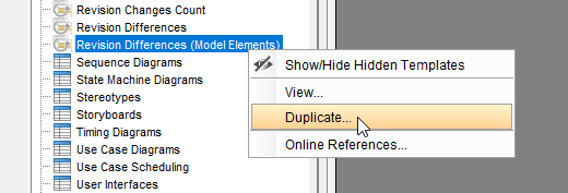

- Right click on the Revision Differences (Model Elements) template and select Duplicate… from popup menu.

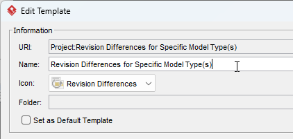

- Name the template as Revision Differences for Specific Model Type(s).

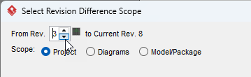

- Specify the start revision for the report and press OK to proceed.
