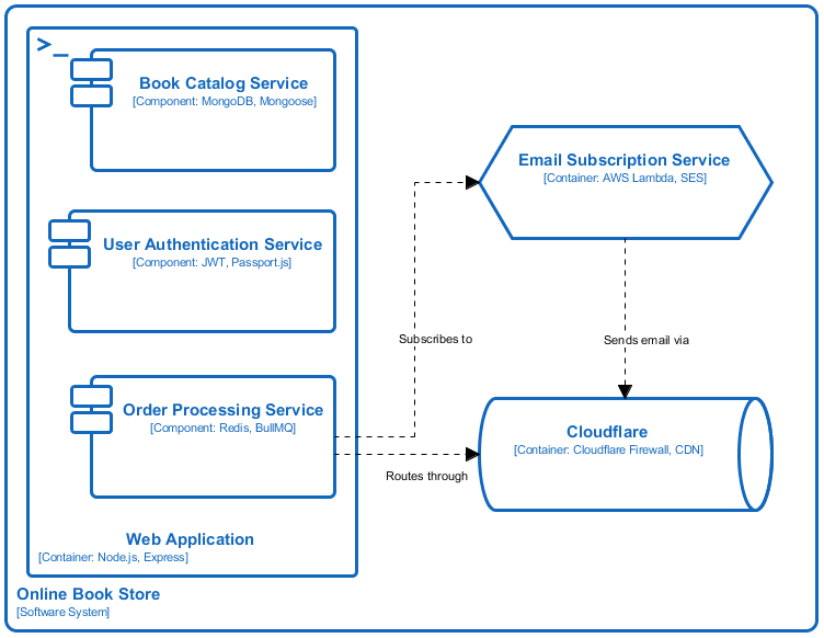

The C4 Component Diagram will be created by the plugin

Create Relationships
With the key elements in place, you can proceed to define how they interact. In a C4 Component Diagram, relationships are represented using the IC4ModelRelationship model type. You begin by creating the relationship model through IModelElementFactory.createC4modelRelationship, specifying the source and target elements.
 // Create relationship model between Customer and Web Application
IC4modelRelationship relOrderProcessingEmailSubscription = IModelElementFactory.instance().createC4modelRelationship();
relOrderProcessingEmailSubscription.setName("Subscribes to");
relOrderProcessingEmailSubscription.setFrom(orderProcessingService);
relOrderProcessingEmailSubscription.setTo(emailSubscriptionService);
Once the relationship model is ready, use DiagramManager.createConnector to create its visual representation on the diagram, completing the contextual connections between elements.
 // Create connector shape for the relationship between Customer and Web Application, and specify it's turning points.
IC4modelRelationshipUIModel relOrderProcessingEmailSubscriptionShape = (IC4modelRelationshipUIModel) diagramManager.createConnector(diagram, relOrderProcessingEmailSubscription, orderProcessingServiceShape, emailSubscriptionServiceShape, new Point[] {new Point(400, 443), new Point(473, 443), new Point(473, 211), new Point(532, 211)});
relOrderProcessingEmailSubscriptionShape.resetCaption();
Show the Diagram
After all elements and relationships have been added, open the diagram to display it within Visual Paradigm.
// Show up the diagram
diagramManager.openDiagram(diagram);

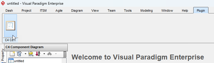

Sample Plugin
A sample plugin is available that demonstrates the complete process of creating a C4 Container Diagram using the Plugin API. After deploying the plugin into Visual Paradigm, you can click the plugin button in the application toolbar to run it.
Trigger the C4 Component Diagram Plugin
Download Sample Plugin
You can click the link to download the sample plugin from GitHub.
