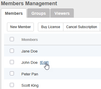

- Select Members on the left menu.
- Mouse over the member who need to have MFA login, and press Edit.

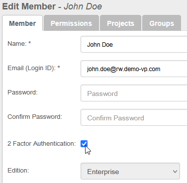

- Select 2 Factor Authentication.
- Press Save button to save the change.

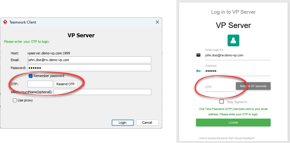

Once MFA being enabled user will prompt for One-time password (OTP) when perform login.

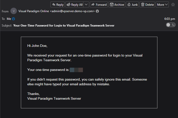

The OTP will be sent to user via email.
