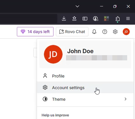

- Press on your avatar at the top right and select Account Settings.
- Select Security.

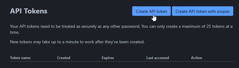

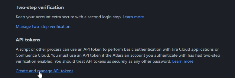

- Go to API tokens and press Create and manage API tokens. Please note that you may prompt for perform verification in order to access to it.

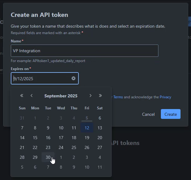

- Press the Create API token.
- Specify the Name and the Expiry date of the token, and press Create button to create it.

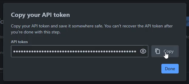

- After the token being created, press Copy button to copy it to your system clipboard. It is recommend to keep it into a safe place in your computer so that you can reference to it later on.

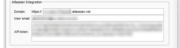

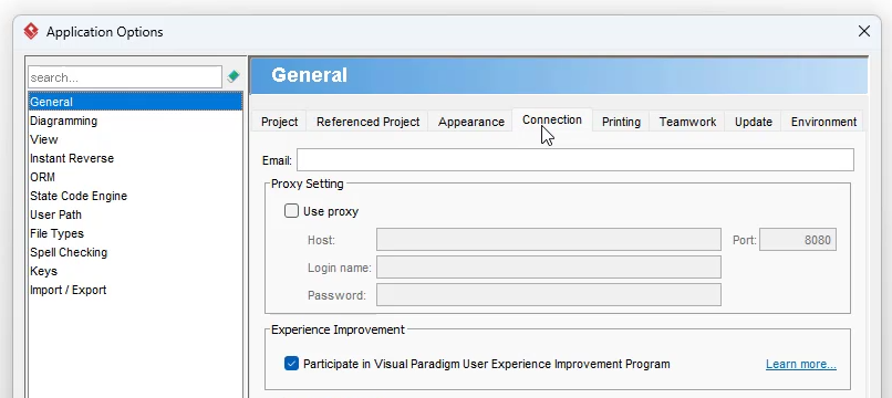

- In VP application, go to Windows > Application Options > General > Connection.
- Go to Atlassian Integration and enter the Domain of your Atlassian Confluence, your User email address, as well as your API token.
- Press Apply button to confirm the change, and press OK button to close the dialog.

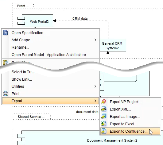

- Right click on the blank area of the diagram and select Export > Export to Confluence, or select Project > Export > Active Diagram to Confluence.

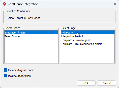

- Select the target space.
- Select <<New>> for publish your diagram as a new page, or choose an existing page to update with your diagram.
- Select Include diagram name and Include description for also output them to the page.
- Press OK to proceed.

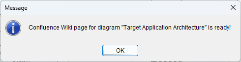

- Once completed a message dialog will shows to let you know publish is done.
Now you can see the diagram being published to your specified space.
